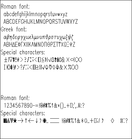

character, where character may be one of the following:
$g
switches into Greek mode, while $r
switches back to Roman mode. The correspondance between Greek
characters and the alphabet is shown in Figure 1. For
example, to make a lower-case alpha, one would use $ga$r
$s
switches to special character mode,
which provides mathematical and other symbols. Figure 1
shows the correspondance between special characters and keyboard
characters. For example, to make a $sa$e
, while a right-pointing arrow would be obtained
with $s5$e
